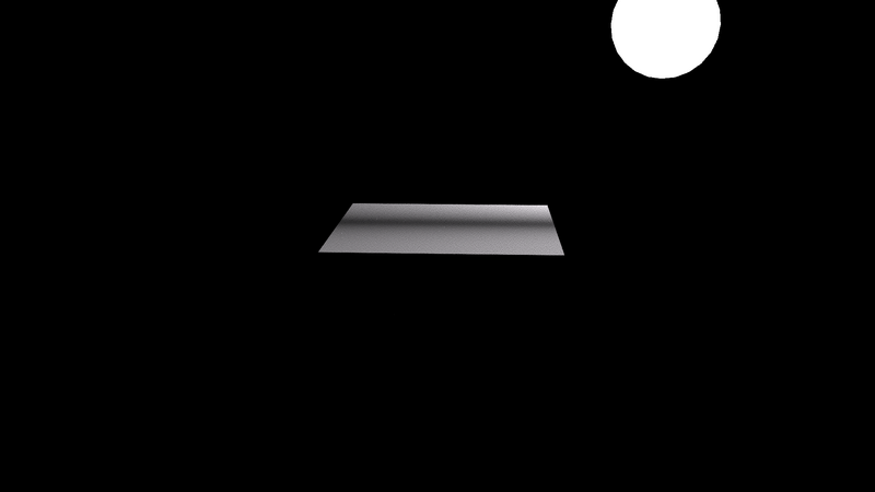

I just installed Reality 4.3.1.16203 for Daz Studio. I've used older versions of Reality before. I tried a test scene, as it's been a long time since I've used Reality, and was getting an error: Severe error: 46] No light sources defined in scene; nothing to render in LuxRender.
I have made a test scene with two primitives in it, one is a cube, one a sphere. I made one camera.
In Reality, I converted the sphere's texture into a light. It shows up in the lights:
Reality "knows" there's a sphere and a cube in the scene:
But when I tell it to render the frame, it doesn't export the light. Here's the entire lxs file:

It's like the sphere disappeared alltogether. I've tried it with mesh lights in the scene, too.
I am using Daz Studio 4.10.0.123
Could you help troubleshoot?
